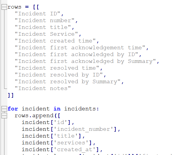

Hi @martin @jcalcada - Let me know if I need to add service into the script -
Let me what I am missing here to get the service name in the Report.
C:\Users\gargv>py C:\PD_Scripts\Incident-Notes-New3.py --services=MiCloudFlex_MiNOC --output_file C:\PD_Scripts\TestIncidentnotes4.csv --start â1 day agoâ
Getting incidents⊠got 116
Getting incident logs⊠got 1163 log entries
Traceback (most recent call last):
File âC:\PD_Scripts\Incident-Notes-New3.pyâ, line 81, in
incident[âservicesâ],
KeyError: âservicesâ
Hi @jcalcada @martin - Appreciate your help here as looking for the solution on this Pagerduty reporting
If you run a GET API call on an incident (you can use the snippet below for example output), youâll see it contains the service name and id. Youâll need to factor that into your code and you can certainly get that information from incident details. If you need help with developing a more robust solution one option you have is to leverage our professional services organization who would be happy to create something for you for a nominal cost.
